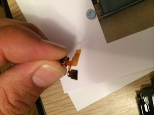

Power button ribbon ripped and trying to replace it. I have new ribbon/button part but how is it actually connected to the top PCB? Old button assembly appeared to be adhered with heatless solder paste - but how should the tracks be aligned for this to be used?
Desperately need to fix daughter's phone...
Thanks in advance
looks like it is soldered on. Have you tried to use a soldering iron yet? Any chance you could post an image of the connection on the board so we can see what you see?

did any one figure out how this button attaches.. the old button just pealed off cleanly.. no sign of solder.. I'm hoping its some sort of heat activated dry glue.. will let you know if I get any success with this.. wish me luck.. I'm going in..
hey, can you tell how did your repair go.. does the button glue to the motherboard?
thanks
Hi Cheng, It didn't go well.. I gave up eventually and bought a second hand PCB with the button attached.
Cheers, Paul
Will have to dismantle assembly again first...
You may be able to see from the power flex cable pictures themselves

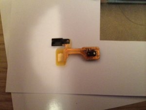

Received new power flex board and installed it last night. Hardest part was transferring the foil from old board. Now have a power button again but stuck in bootloader. Can see a factory reset on the horizon - didn't want to lose personal data... :(

Hi, Unfortunately not.. I ended up buying a second hand PCB for £23.00 from eBay, I couldn't find any information on how to attach the button flex, soldering didn't work, even bought a microscope to see exactly what was going on, but just couldn't get the button flex to stick at all.. I gave up, but would still be interested to here if any one discovered a reliable method..
Cheers, Paul
I used conductive glue and it worked but fell off shortly.... Then I used conductive tape and it works, but is always depressed.. I just remapped the button once I got the phone back on
