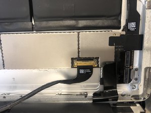

iPad 2 touch screen not working after digitizer replacement
Hi, I have an iPad 2 which had a cracked screen, so I went online and bought a replacement immediately.
After the tear-down and replacement of the parts, I placed the screen on the device (without the adhesive) to test it before sticking it down. However the touch screen is completely unresponsive but all physical buttons work fine (home button, power, etc), So I wonder whether it's a faulty digitizer?
This problem is very frustrating as the iPad clearly works because the LCD is on, it syncs with iTunes etc. but without the touch screen, which without it makes it useless!
So I'm wondering what i could do next? Should I contact the company who supplied the new screen and request a replacement as I assume it's faulty OR should I assume that there is something else wrong on the iPad (ie logic board, faulty connector, etc!)
Thanks for reading and hopefully someone has some advice or even a solution to my frustrating problem.

I had the exact same problem after replacing the glass on an iPad 4. The touch screen was totally non-responsive. I reseated the flex cable all the way in to where I could not see the white indicator stripe and the cable would not go in any further, then I locked the zif connector and it worked flawlessly.

Hi, should have commented back before now but anyways, my iPads touch is now working great! Turns out the connectors weren't pushed all the way in! Silly me! The white lines need to be flush against the connector and requires some force with a tool to get it in properly!

Before you start blaming the motherboard make sure the connections are pushed all the way into the connectors and retaining clips pushed down if it is then most likely a faulty screen

Thanks for the reply, all the connectors are fully plugged in. Display is working with the LCD, but still no touch. I'll get in contact with the screen supplier to arrange for a new one to be sent!

YES~ This worked for me. The white tabs show up on the connection from the digitizer cable to the port where you plug the digitizer in. I used a black stick to nudge the connector in while holding the ipad down firmly. Now it works woohooo

I tried replacing digitizer on the iPad 2. After restarting the lower part of the screen seems to be irresponsive, while rest of the screen is working. Hence the problem is getting the onboard key pad to work. Please let me know what i could be doing wrong while replacing digitizer screen
I’ve attached a photo of the white lines that need to be pushed in right up to the host connector.
