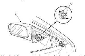

Honda Civic, here is what the manual says:"
Power Mirror/Manual Mirror Replacement
1. Lower the door glass fully.
2. Carefully pry out the mirror mount cover (A) by hand in the sequence shown.
3. On power mirror model: Disconnect the connector (A).
4. While holding the mirror, remove the nuts securing the mirror, and remove the mirror
(manual mirror model).
5. On power mirror model: While holding the mirror, push out the connector clip (A),
and remove the mirror (B). Take care not to scratch the door.
6. Install the mirror in the reverse order of removal, and make sure the connector is plugged in properly (power mirror model)."
Hope this helps, good luck.
On my 2004 Civic EX, the door panel obstructs access to the lower hex nuts.
@mlsmsw have you tried to remove the door panel?
I can see that the door panel must be removed. My point is that the instructions given in this post do not apply to my vehicle, and I am puzzled that the post references all seventh generation civics when clearly that is not the case.
