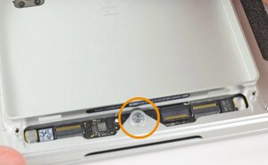

The best I can offer you is this IFIXIT image of the trackpad on a different model:
Here you can see the adjustment screw which is the large head screw circled is the adjuster. If you replace the battery often the frame can warp a tiny bit so do check the level of the case using a straight edge across the plane once the case it's self is level using a fine depth gage or digital measuring caliber.
Again this is a very big job as almost everything needs to be removed to get to the trackpad.

@danj Any chance to post the picture of the location of the adjustment screw in the answer as I have to adjust one of these, New battery is safely out etc ready to adjust a non responsive click (No play) TP.
@livfe - I had posted originally an older model in a link. Here's a better picture of this models. If the battery swelled the tang tends to bend. I suspect Apple either reduced the metal structure or was using a lower grade of Aluminum (softer) as the 2014's often need a bit of a bend to fix.

OMG dont go by that picture. thats how to remove the trackpad, and this is only for the 2012-14 retina. the 2015 retina has force touch, a whole different monster. If suddenly you cant click your trackpad, do you keep your MacBook plugged in all the time??? because your battery may be expanding! get that thing in for servicing quick!
crwdns2889612:0crwdne2889612:0 -1
This is a 2013 system not 2015 which agreed is very different!
@danj have a 2015 model and there is no visible screw to adjust (2013-14 are different) :( I have ordered a replacement TP & Cable for $12 from a local supplier of MBP parts here, that should fix the problem :) Thanks though for adding the pic for 2013-14 models :). I recently put in a new battery so it came out quite easily, I just need to use some fresh DS tape to stick it back :)
@livfe - That is correct the 2015 systems onward don't have the adjustment screw! That's because they are haptic, that's the coil you see underneath which vibrates (under the metal plate on the '15 model) MacBook Pro 15" Retina (Mid 2015) Trackpad. Visible here in the 2016 MacBook Pro 15" Retina (Late 2016-2019) Trackpad
You need a new unit or cable if it's damaged. The Q was on the 12~14 models.
