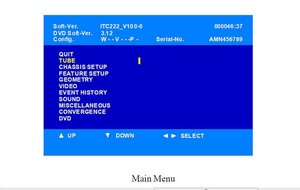

I seek a proceedure foradjusting convergence prior to commencing any repair.

Service Mode
Most of the alignments for this chassis are software-driven.
Most of the alignments must be accessed and modified through the front panel service mode.
Entering the TV Service Mode Using the Front Panel Controls
1. Press and release the POWER button to turn the instrument off.
2. Wait 10 seconds before trying to enter the Field Service Mode.
3. Press and hold the VOLUME DOWN and CHANNEL DOWN buttons for at least 8 seconds.
4. The instrument will switch on and come up with the field service main menu on the screen. LED will illuminate
before the picture comes up.
The instrument should display the following menu:
Main Menu
The CH /\ and CH \/ buttons on the front panel are used to navigate up or down in the menu.
The VOL + and VOL - buttons on the FPA are used to select a menu item or decrease or increase a value in a selection list.
NOTE: Before the Field Service Mode is exited; you must check STORE or all changes to alignments will be lost.

Main Menu
Soft-Ver: Displays the current software version.
Runtime Counter: Displays the total runtime in hours and mintues.
DVD Soft-Ver: For DVD models only, displays the current software version.
Config: Displays the configuration code of the instrument. Each character represents a particular hardware feature or option.
Serial-No.: Displays the serial number of the instrument.
