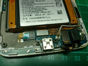

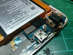

A grey white washed screen? I experienced this problem when replacing my screen and found out why this is happening..
When connecting the ribbon from the screen onto the bottom board that has the charging port (this), the ribbon has a small amount of circuitry and components (the second piece from the left). The original would have adhesive to stick to the (charging port) board, and the absence of that means that the circuitry will touch against the metal part of the (white) antenna cable that is connected there too.
After trying (and failing( to adhere the ribbon firmly to the board underneath, I simply cut a small piece of electrical tape and placed it in between the antenna and ribbon and solved the problem.
Hope this helps!
crwdns2889612:0crwdne2889612:0 29
crwdns2944067:044crwdne2944067:0:
basically make sure that the copper piece of the white antenna wireing at the bottom board dosen't have contact with the circuit board to display ....
I had this exact problem (milky white with streaks) and this fixed. I used a piece of plastic and put it in place with tape.
I can confirm that this was also the problem on the LG G2 I was repairing.
Here is a 'before' and 'after' photo of the area that I placed a small piece of Scotch 3M Super 88 vinyl electrical tape over to resolve the issue.

thanks for this, have been living with a dud screen for ages, really appreciate it
Thank you so much everybody specially Craig Jessup to post the pictures, yes, it was causing the problem and the fix worked.

I found that my lines were coming from the bottom part next to the LCD connector. It's not a connector but it's suppose to sit flat. The gap is what was causing the lines in the screen. I put electrical tape on it to hold it down and I haven't had any more issues. See image!
Sir, i also have a lg g2. Which also start showing the different lines on screen . So i am here to know whether this technique can help me or not., .. My lg g2,s screen is like : http://i57.tinypic.com/300tc8z.jpg
PROBLEM SOLVED!!!!!! MANY THANKS!!!!!!!! Just do what the man says! Electrical tape where the picture shows, maybe you have to unplug the antenna first (white cable)! Very easy to fix!

As before, I've had a big Dropbox clean out, so my old links to the photos posted previously are no longer valid. To get around this being an issue in the future, I've uploaded the photos directly to my iFixit account.
Before:
After:
All Fixed:

The white antenna cable doesn't affect the LCD, so don't worry about that side of it.
Make sure the tape you're using is electrical insulation tape - you don't want any residual charge whatsoever getting through it. It's plastic tape, usually made from vinyl.
The blue tape you mention just sounds like packing tape to keep the connector from moving about too much in shipping.
