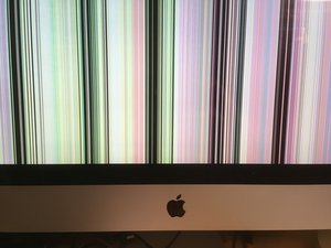

Hi everybody, my name is george and i'm from germany.
i bought a faulty imac 27 2009 i7 with harddrive damage but the seller didnt told me there were these digital vertical stripes all over the whole screen.
so i waited a few weeks to buy another imac 27 2009 i5 with just another cpu and a faulty gpu which i repaired and now its working very well.
so i startet replacing the parts of the imacs to analyse the problem.
i ordered new lvds cable and v.sync cable. replaced them but nothing became better.
i replaced the lcd und nothing was better.
after that i replaced the power board next to the power supply and also i replaced the power supply. still nothing better than before. it cant be the gpu...
i didnt try to change dumb things like the odd, camera, ram or cpu.
maybe i should try that next.
i want to repair that device and i will. but maybe i need some help from someone else. after that we will definitely know what the cause for that apple fault is.
i think its the internal display port or damaged ic's in it or something else on the motherboard.
also very important, i tried the mini displayport to hdmi. perfect screen on my tv, no lines und no problems.
so what is it!!!???
now, a few hours later, graphics card replaced and still nothing.
pluggen everything thats not needed off, but still nothing.
so its definitely the motherboard and something is wrong with the internal display cable port.
but what is it!!!
help!
2 hours later I soldered all the connection points from the lvds port to clear out that there are no dead solder points.
also its not the connector, maybe it is, so i would have to order a new port to solder it.
no one has the solution and i know i am not alone.
please help me to clear that problem.

@Dennis Khan - The trick to prove if the display or the GPU is bad is to plug in an external monitor. If the external display looks OK, the internal display is bad. If the external display looks bad then it's a GPU failure. We still have a few of these (EMC 2374) which we use as test stations both are running newer versions of OS-X Yosemite & El Capitan without any problems. Over the years many had GPU failures when we pushed them hard. Are you running some heavy graphics on your system like gaming? That will kill your system as the current near real life graphics is just to much for this old boy.
crwdns2933315:013crwdne2933315:0
Since the external video is OK I suspect the cables or connecting points at the end of the cables - if you are certain you have the correct (matching) LCD. Try pressure at the connection points, try moving/rerouting the cables.
If this answer is acceptable please remember to return and mark it.
its definitely the same lcd, i have three of these. one ordered at ebay and one from my other imac which works very nice.
the cables i use are brand new, and i after your help, i tried to bend the connection a bit and put a bit more pressuse on the cables, but nothing got better. shell i replace the port??
"nothing got better" but this is the 'chosen solution' ?
Did you try swapping-in the known-good GPU ?
I know there were problems with early NVIDIA 'BGA' (Ball Grid Array) GPU chips - 'Bumpgate'- reflowing the solder fixes it again, for a while. Loads of eBayers offer the service, some people have successfully held theirs over a candle !

I got a free 27" IMAC because of this problem! Fix was simple! Boot from MAC osx Snow Leopard CD. Erase and repartition internal hard drive. Install MAC OSX Snow Leopard, then install additional software from folder on install CD. Once install is complete the bars went away!
Presto!
OSX Snow Leopard Install Disk was ordered from Apple for less than $20.00. iMac was donated to local computer recycler that only accepted PCs. So they gave it to me.
Do not upgrade these machines beyond MAVERICKS!
God Bless and God Speed!
Professor out.....TZZZZSSSSSSSSsssssssssssss.
Did somebody else tried this?
Yes definitively !!!
On two Imac 27 inch 2009, same issue, same solution to fix the problem.
I'd disassembled the two machines in order to check all connection, refected thermal past.
The first time, I'd take a try with Yosemite 10.10.3 but after the reboot, the iMac was very very hot and strange things appears on the screen then the gpu card temp was not acceptable to work in good condition.
To resume, never upgrade this model to another version than os x 10.6.8

Hello everyone,
since i hadnt gotten a reply soon enough, ive taken this iMac in to my supplier and tested it with a bunch of known-good-parts.
I've swapped the LCD (twice), V-sync Cable, Inverter Board, LVDS cable, even all of these items.
The vertical wavy noisy lines remained visible.
After logically assessing that this cannot be the video-card (digital video artifacts or any other typical GPU related issue generally looks totally different, plus this has a sort of 'analogue-ish' look to it: the lines are like an old CRT-screen that has gone bad, or an old TV that's got bad reception on the coax cable) Ive concluded that it must be the Logicboard, and probably the LVDS connector on the board.

Hi there, i've seen this several times on different iMac's (all 27 inch models).
It seems it only happens on the models with a v-sync flatcable. The later models with a "normal" connector and separate wires seems not to be affected.
At the moment i have an iMac with the same vertical lines with the additional problem that the whole screen goes black after a few days. When i pust the power button 2 times (standby and out of standby) the screen appears again. The external monitor is not affected and keeps playing when the internal scheen goes black.
Already did a reflow of the GPU and changed the inverter board but no difference.
Did the image look OK on an external monitor? If it did the issue is within the LCD panel and/or its wiring to the logic board. Black lines tend to be bad driver logic on the back side of the LCD screen. Not much you can do here other than replace the display unit. Not sure why you thought it was the GPU (if the external display was OK) or the inverter board (CFL backlight power for the LCD display)
I have exactly this. Evenly distributed groups of four 1-pixel wide, faint noise lines with the noise moving upwards and the screen goes black every other day.

I am pretty sure that the source of the problem is the controller board on the back of the lcd panel. It probably degrades with the heat produced by the gpu and cpu. I read pretty much all there is to read on the internet about that problem so my guess is that our lcd panels are fine but if we swapped just the controller board from a known working screen that has no lines, it would work perfectly. If i am right, finding a completely trashed imac on ebay just to use the controller board could be a cheap fix. I found the datasheet of the screen on google by searching for LM270WQ1-SDA2 (iMac Late 2009 i7 2.8). Sadly i am in no way able to understand and pinpoint what could be wrong by reading this but an electronics engineer or technician probably could. It could be a matter of replacing some surface mount capacitors who knows?
Hi Anthony,
I have had the same issue with the faint vertical dotted lines on my 2009 27” Mac
I have just replaced the T-con board on the back of the LCD panel with an identical replacement unit from Aliexpress
This did not solve the issue
After seeing the feedback about this only affecting the early models with the flat (ribbon) V-sync cables, I then swapped the T-con board from a known-good 2010 model, with the later multiwire V-sync
Sadly this did not work either!
I have also connected the display to the chassis of the 2010 iMac to rule out any problems with the LVDS connector on the motherboard
From this I have deduced that the fault must lie with the 2 boards which connect directly into the LCD
It seems unlikely that it’s the LCD itself, because the pattern seems so regular and akin to signal interference
The 2 boards which connect into the panel have microscopic ribbon cables heat-bonded directly, so these cannot be replaced, however there aren’t many components on the board, so it wouldn’t be hard to replace those
