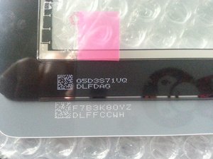

1. The QR code. The one on fake digitizer is a little big and scattered. You can see the picture one. Black one is original and the white one is custom.

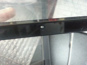

2. If there is a visible but can't feel ring around the front camera hole like picture two, it must be original one. And the fake one doesn't have. That's the most important evidence.

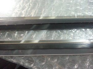

3. If you found there is the glue traces around the edge of the digitizer cable, it's likely the custom one. because the original one is manufactured carefully with original adhesive but the fake one is glued together. You can see the picture three.
