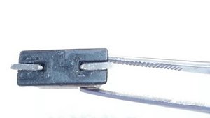

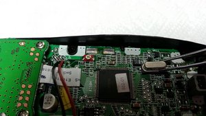

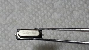

Uniden Model: TCX800 handset - a capsule shaped piece (12.2M-4KU) broke off the circuit board. It looks as though it was glued on. If so, what type of glue do I use? It is obvious that I am not a student, just a mom with a broken phone.

I did not see where I could edit on my original post so I've added the images here:

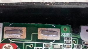

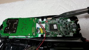

Kelly Creech, any chance you could post a couple of images of the component as well as the logic board so we can see what you see/ Parts like this are usually not glued but surface soldered. To add images to your question, follow this guide Adding images to an existing question
Kelly Creech, that component looks like a Crystal/ Oscillator which would correspond with the "X" as reference designator. Most likely a 12.2mHz and I am sure we could locate that if needed. Right now, you can strictly solder it back. All you need is a small soldering iron some flux and solder and a bit of practice. For some decent tutorials, check here and hereas well. Hope this helps, good luck.
Hi Kelly,
You can totally solder that back on mama! Just make sure you don't "just try and superglue it and see what happens" --that won't work and it will mess things up for when you have to do your solder work.
