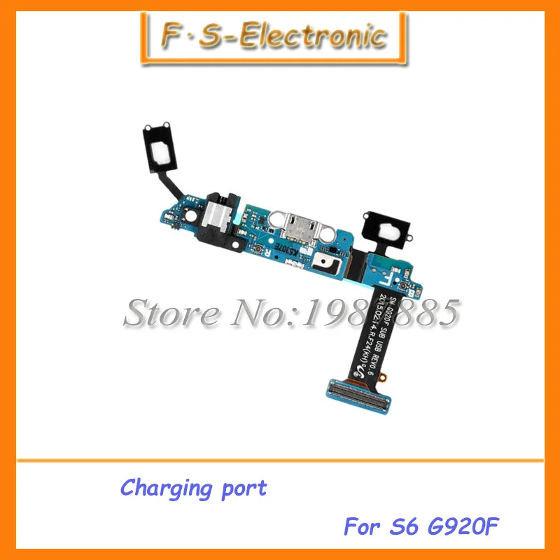

Part 1---I have dozens of times. It really is not difficult. that being said I am an Electronics Engineer there is a much easier way to do this though. you can get the whole part with the port soldered on already from all over like this one
https://ae01.alicdn.com/kf/HTB1fdJrMXXXX...
Part 2---just make sure that you get the right one for your model of phone. then all you have to do is open the phone without breaking the LCD or the digitizer/screen when you open your phone and be mindful on how to put it back together. a good practice is before you remove anything other then screws take a picture, they will automatically be in order by the time they were took and you can do it just as easy in reverse. last note be careful trying to turn the screws out and open and close the different plugs, it really doesn't take much strength to destroy something on the board if you tool slips off the screw. Good Luck its not as hard as you suspect slow and careful. ~COVACS if you want to see what it takes to dismantle your phone i really like iFixit really cant be beat, correct information and it is clear and concise : https://www.ifixit.com/Teardown
