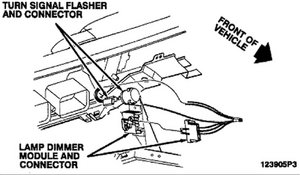

Where is the turnsignal flasher on 94 cavalier?
I found the hazard light flasher but not the turn signal flasher
Johnny Hale, the turn signal flasher is located located behind the instrument panel, on the left side of the steering column bracket. Replace the flasher by unplugging the old one and plugging in the new one. (usually;-) Hope this helps, good luck.
Thank you! Your diagram is way better than the one in the Cavalier shop manual.
