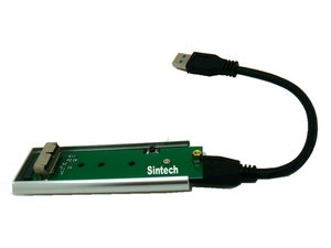

I'm looking for an SSD to USB adapter.
The SSD in my model is no longer the standard SATA connection. Apple changed the interface on the SSD.
The pin count on the SSD is 11+14. I need this adapter because the logic board died. I need to copy data from the SSD.
I'm looking for a device where I can copy data from one of these newer style SSD drives.

OWC web site is a bit confusing here. Apple converted to a M.2 PCIe SSD on the late '13 MBPr model. As such there is no hardware that is compatible yet with this model. But, the '12 and early '13 models do have an option, which is what the link was about. Now lets look at the question from a time point and read the rest of the posts. While Brian had noted his NEW system was a late '13 (PCIe based) he likely did not have this model for his broken unit (early '13 or older). So while he is implying he needs a newer PCIe case in truth he likely needs the older Apple proprietary SSD case that OWC does offer to put his older SSD unit into to copy the data onto his new system.
FYI, i have the same problem. Macbook Pro Retina (Late 2013) which had it's logic board killed by a cup of spilled tea. All the data is still on the SSD and no way to get it off.
I did see this M.2 SSD to USB adapter.... http://www.ebay.de/itm/221394861961 but not sure if that will work.
I guess i'll need to wait and purchase a new MBPr and then swap the SSD's to access the data.
One of the issues with the M.2 spec is the looseness of the data interface (it's just the mechanical side that is spec'ed). Which is why finding compatible hardware for Apple SSD units (or SSD's) will be harder. To add to the confusion the data interface is programed into the SSD! So you could have the same exact units side by side and one will work in an Apple MBPr, iMac or Mac Pro system and the other won't (we found that out the hard way).
Best to follow OWC site on what they are doing for the newer MB air, iMac & Mac Pro systems as they all have these newer PCIe SSD drives.

If I understand, you either have A1493, A1398 or A1502 printed on the back of the machine. The card is the same for MBA models A1465 and A1466 Mid/Late 2013-2015 (there is some crossover with the earlier models of the same number). These cards use a PCI-e interface, sometimes referred to as mini PCE-e or mPCI-e, this is a different interface than all previous versions that used mSATA or SATA interfaces. This allows for faster speeds. Currently the only adapter is mPCI-e to PCI-e which would allow you to plug it into a motherboard on a desktop computer in a regular expansion slot. If you find an adapter for this newer card that goes out to SATA, I would like to know, I have been looking for one for days.
Good News! OWC now has an external case for MacBook Pro 15" Retina Late '13 SSD's. If you have an air check out the link as well as this will also support some versions of it.

you can buy Sintech 28pin to USB 3.0 Adapter for SSD SSD From 2013-2014 Macbook A1465 1466 A1398 A1502:http://pc-adapter.net/products/794.html
Can i use this to transfer files to another computer? im trying to recover deleted files and now have a PC. I downloaded a program that will allow me to recover these files however i need to take out the ssd and connect it via USB to my PC.
