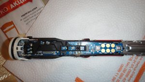

I agree with Jeffrey. I have just published a guide on how to open a Philips Sonicare toothbrush to repair the actuator. There you can see the format of the battery. I think it can be useful when replacing the battery, too.
Oral B battery is possible to replace for someone who's fairly practical, I've done several including for friends. Their supplied battery is pretty poor I think. There are some good tutorials on YouTube.

Hey, i am trying to do basically the same thing ,but on a phillips sonicare hx6930 and i can't find the + and - of the battery so i can unsolder it ,even though i saw a bunch of pictures explaining it, it seems like it's not where it should be?
You'll find the polarity of the battery at 00:50 https://www.youtube.com/watch?v=bA1-FllL...
