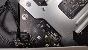

I have one of these iMacs and, following your advice, I looked for the resistor and found that I too have a missing one right next to the power button connector. I touched one of those color banded 10kohm resistors to the contacts and immediately got an RPM reading for the CPU fan. The fans turned right down and the computer seemed much happier.
Next step is to have someone more skilled than me place a resistor on the board but this is definitely the culprit.
I took a couple pictures so anyone else with this issue can pin it down. FWIW, the spot was fairly easy to find once I knew it was near the power button connector. Only had to remove the glass, display, and power button cable to find it.
From afar: http://i.imgur.com/8W8SpxR.jpg
Close-up: http://i.imgur.com/hbvNIE3.jpg
Okay so the actual resistor for that is a 47K 1/16W 5% in a 0402 package.It's around $0.10 at places like digikey.com etc. It does control the Fan Tach circuit

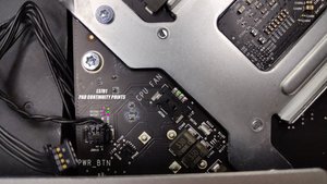

Hey scallejam, seems to me your L5701 is missing. L5701 is s labelled on the spec as FERR-220-OHM 0402 .
I uploaded image for reference of its continuity points, hope it helps!

Anybody know what the value of L5701 is? I accidentally ripped the %#*@ pad of the side that goes towards R5797...currently testing (jumping) with kynar and a couple resistors. Thanks.
Just in case someone else encounters this apple hassle, L5701 has no value...added a 0 ohm resistor from another junked PC board, jumped it with kynar to the corresponding spots (because of ripped pad) and fixed the issue.
You need a steady hand, magnifying glasses, fine tip, voltmeter, experience with tiny resistors and a friend with mac to know where is and not continuity on those resistors in order to accomplish this type of repair. Good luck!
If somebody else finds this post referencing the L5701 and if, like in my case, the contact pad was ripped off along with the component: the Mac can be fixed by running a wire from the CPU fan connector (second pin counting from the top down) directly to the right side of the nearby component 1R5700.
I can confirm that @iphone3ghulp's tip worked fabulously. Thank you for sharing!
Check if you have missing resistors on that area of your motherboard...that can cause a full speed cpu fan (0 RPM).
