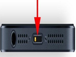

If you’ve ever gone to plug in your iPhone or iPad and noticed that it’s not charging as it’s supposed to be, you might want to check the devices Lightning port. That’s because the little charger port on the bottom can be a trap for pocket gunk, and even fairly small pieces of lint or sediment can prevent the device from charging as intended.

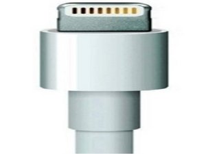

The simplest way to check this is to flip your iPhone or iPad so that you can look at the bottom of the device, if you see anything at all in the Lightning port, that’s probably the culprit preventing the charge. You’ll want to grab something like a wooden or plastic tooth pick to get the object out, but you may have luck with a tiny brush or other object as well – just make sure it’s not metal and that it’s not wet.
Once you’ve cleaned out the port, try plugging it back in again. It should work. If you’re still having problems, it could be due to a badly frayed USB cable, which is always quite obvious, or a shoddy third party cable that is unsupported by Apple.
ran into this recently on my iPhone and discovered a piece of pine needle wrapped in pocket lint with a tiny pebble stuck in Lightning port, it was preventing the Lightning cable from making a complete connection, though it sure looked and felt like it went in all the way. After searching around to see if this was a common issue, I discovered CNet also offered the same advice, so it’s definitely fairly common.
