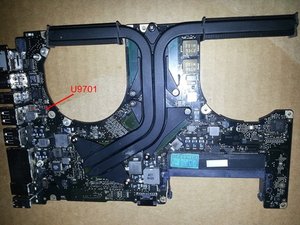

Can someone tell me where the WLED driver on this Macbook Pro? This is a Macbook Pro 15" 2.8Ghz Mid 2009 EMC 2324. I have also included pictures. Thanks in advance.

I just uploaded the pictures. Sorry about that.

Kevin, check the EMC number on image #1 it shows EMC 2324. you sure about the EMC 2255?
Kevin, for the EMC 2324 as it shows on the images you uploaded, the LCD backlight driver has reference designator U9701. It is a LP8543SQX manufactured by TI. the datsheet is available right here. The part itself seems to be a bit hard to come by, but it is available :-) Hope this helps, good luck.
