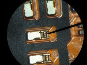

So I successfully replaced the screen door the n5 after a run in with a brick floor in Arizona. Is all together but now the wireless charging isn't working. As I believe it to be the magnetic circles in the back cover and two leads coming off the to left.... I can't understand why it won't see it to charge it. What an I missing? Any ideas?

I had the same issue before when I swapped the back on my N5. Try making sure the last clip is snapped in place the centre of the phone. It holds the contacts to the wireless coil.

I also seem to have broken my wireless charging after removing the back. I had missed the middle snap that Scott mentioned, but snapping this only made it work intermittently for a few days. It is now back to not working at all, and I can see nothing mechanically wrong.
I'll be interested to see if you find a fix....
Edit: I seem to have found the problem in mine. After taking the back off several times, and looking at it under the microscope, I finally noticed something. Where the needle is pointing you can see a small brown spot on the top of one of the springy contacts. This picture was taken _after_ I scraped off a dark brown mass that looked like it had melted on. (Note to self - take before pictures too...)
My theory as to what happened is that when I put the back on without a good contact (the middle snap loose) there was some arcing that melted/oxidized the contact. This prevented good contact from being made. Now that I have scraped that off (which was pretty hard to do), it seems to be working again. For the last 5 minutes at least...

I almost had the same, I just noticed it wasn't make proper contact. So I pushed them out a bit for better contact. Worked like a charm

Cleaning with electrical cleaner was the key for me. I just cleaned all contact points, and Walla! Back in business. Thanks Roy!

I had the same problem as roy, apparently. However, not snapping the middle snap of the back properly had left little craters in the gold contacts on the back, the springs on the phone side were OK.
Scraping and cleaning the contacts in the back with tuner spray was not enough. I slightly bent the tiny spring contacts on the phone side sideways (with a needle) so they now touch unharmed surface of the gold contacts in the back.
