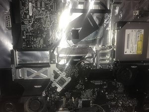

I have tried to install a quadro k1000m into the iMac 9.1 24inch early 2009 with the plastic backside and the smallest processor and I found out it has no graphics card to switch, it must be an onboard model. It seems like only the model with the 2,6 ghz processor has an onboard gpu.
Your Imac has integrated graphics card.
You can't to change it.
And even if you change it, the motherboard does not recognize it, because the MXM slot is disable in Imac with integrated graphics card.
And there is no BIOS to change these settings.
Also you cannot install quadro k1000m into the iMac 9.1 because it is not supported (many have already tried).
