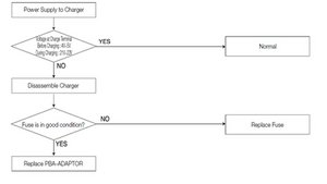

circuit diagram or schematic for accu loading
The Bot Device cannot load his accu.
It does not recognized the contacts of the docking station. It still search and find the docking station well, but search endless the loading contacts.
I'm still good in electronics but do not have any schematics and don't kow any about the firmware/programms of a lot of microcontroller build in.
Have you checked your charging pins to make sure that you have power on those?
Chech the power switch at the bottom of the vacuum cleaner. It can cause no charge issue, and other strange behaviours. I had to repair that 2of 2 devices.
Very good help. Changing the powerswitch solved the problem ! Thanks

tomtom, check the charger first.
oldturkey03, I have torn apart my charger and am seeing voltage at the fuse. However, no voltage at the charging pins. What could be causing this?
You'd have to check the components after the fuse. Check the caps
