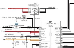

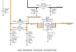

Rob, check on this. "Fake" charging is usually caused by a failed/damaged charging coil. Check for any physical damage, or if you have the knowledge and tools, check for function. You want to start by checking 3 inductors. For that, of course, you need a multimeter, or at least an ohm meter, to check for continuity. I hate to refer to those as fuses, but they most certainly control part of the charging circuit. First one is reference designator L3, it is a FERR-120-OHM-1.5A inductor. L4, right below it , has the identical value. Next would be the charger inductor L28 2.2UH-1.8A-155MOHM. All of these are pretty much available at mouser. com or digikey.com. Check the Diode D604, located just above L28. Hope this helps, good luck.
You saved my iPhone 4S, oldturkey03! L28 had no continuity, I got the same ome from an iPhone 4-mainboard.
