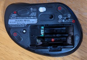

Where are the screw locations for disassembly?
I am having a hard time finding all the screws to disassemble the mouse. I have located three on the exterior of the mouse unable to disconnect the shell from the body.
I have tried to use a micro screwdriver to try and pry apart the shell but in the attempts, feel that It will break if I try any harder.

Okay, found them, but then I would have never figured that they would put screw holes under the stickers that have the manufacturers information and what not. This is information that you may need, yet gets tore up from having to peel it off to access the screws.
There are 5 total screws that have to be taken out. There is one that is located inside where the batteries are and the other four are located around the edges on the bottom. None of which are visible. You must take off two stickers that sub as gliders (if you want to call them that), the other two are under the information stickers, you can peel these back carefully without damaging the information if this is important you).
There are 3 that are identical and then 2 of which are completely different, so I suggest that you lay the screws out in the pattern that you removed them. This will help placing the screws back into the correct holes.

To save you from unnecessarily damaging the mouse, here are the locations of the screws (marked in red circles).
On some of the more compact models of wireless mice (at least with my Logitech), the clamshell of the top is partially hooked onto the bottom. If that’s the case, there will be only two tiny screws under the rear slider “feet” stickers of the mouse but no others. Remove those screws, and pop the rear open by only 2mm or so. And that’s as far as it goes so don’t try to pry it open any further in that direction. Now push the top half of the clamshell forward vs. the bottom half. (Like you’re trying to shear it along the plane of the seam between the halves.) Should unhook at the front of the mouse and easily come open the rest of the way. Be careful when doing this. There may be wires going to the upper clamshell half for things like lights, and you don’t want to damage them. The rest of the mouse should now be accessible for cleaning the inside. Putting together is kind of the reverse, catching the hooked end first and then pushing the tail back down before screwing it together.
