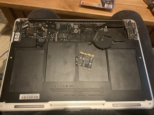

I managed to extend the wires in my mid-2012 MacBook. It is necessary to remove the left side I/O board to access the two screws securing the antenna wires on the left hinge. I then used scissors to cut the wire from the thin metal plate (bend away the two narrow metal legs from the wire and cut the legs but not the antenna). I guess one could also desolder the antenna wire from the metal plate in lieu of cutting. After doing this, the wires will have just enough length to reach the antenna connectors on the 802.11ac card.

Thanks to Kevin Ko’s idea, I tried to modify the antenna wire and connect to the new ac wifi card, and it works!
Check the red arrow, I cut off this little metal plate, in order to elongate the antenna wire.
Connect the antenna. The new wifi card(94360cs2) is a little longer. So thanks to John Pr’s advice, electrical tape is highly recommended for it.
Perfect. Thanks for the pictures. My only question is, that metal plate that you cut was attached to the hinge screws, so it was grounding it. Does it not need to be grounded? Why would Apple have grounded out the wires to begin with?

I have just completed this install as documented above. Used the wifi card 94360cs2 as mentioned previously (attached photo showing difference in length). It works great, have now got AC wifi and can unlock with apple watch on my Mid 2012 Macbook Air.
I had to follow Kevin Ko’s guide to lengthening the cables (not for the faint hearted)
Hope this helps

So I used a 94360cs2 which is few millimiters longer. It hits a component on the bottom, so i added some electrical tape under.
Now I can successfully unlocked the air with my watch now :)

I know this is old, but wanted to post I also did the same thing with my MacBook Air 2012. One wire is shorter than the other. I unscrewed the wire from the hinge as posted by Kevin Ko. Leaving it unscrewed, you can stretch the wires the length you need, however the wires couldn't be underneath the board anymore where they originally were. I now have them just stretched across. John Pr said he can now use his watch to unlock, however, I get an error if I try to enable this function still. "Your Mac was unable to communicate with your Apple Watch". So, I am not sure how John got his watch to work with it. MacOS does show under WiFi "Auto Unlock: Supported", so not sure why it's not working.
Update: I was able to resolve the communication error with apple watch.
I followed the steps on this forum https://discussions.apple.com/thread/251...
After that, I rebooted the MacBook Air, signed out of iCloud on MacBook, and re-signed in. Then I was able to enable the Auto Unlock feature.
Only other issue I have noticed with the new WiFi card is, on boot when you hold down Option, no networks can be detected. I assume it's because the driver is embedded into the MacBook's firmware so it doesn't see the new driver. Miner issue as I never really use this function, but if you want to restore your MacBook Air with COMMAND+R on boot, it doesn't work with this upgraded card!

After hesitating quite a bit, I opted to make this modification with the BCM94360CS2  module.
It took me quite some time to get some extra cable length, for which I needed to slightly lift the mainboard first. After that the cables were just long enough to fit the connectors.
I thought about the loose ground connector, and I guess the soldered piece of the cable can be extended with a wire, and connected to ground on the original location. However after the mod the WiFi signals seem strong enough, so I left this ground loose. Most likely the other end of the wire is grounded.
The wires are not the ‘clean Apple’ way anymore, and the fact that the module is not secured by a screw is also not ideal, but for normal home use, this should be sufficient.
