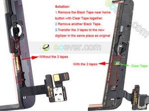

Just read a blog http://www.ecever.com/blog/ipad-mini-hom...
I managed to fix iPad Mini Home button not work problem from it's instructions!Just as first answer said,you should transfer the tapes to the new digitizer.

FYI, I can vouch for the fix, all you have to do is use electrical tape, doesn't have to be anything special, standard electrical tape works fine to cover up the copper connectors to prevent the ghost clicks.

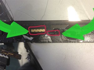

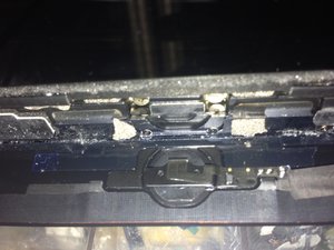

I finally got it as well. The rectangle tape needs to cover most of that flex cable I literally had to work on it for 3-4 hours. Any questions email me
Hi everyone. I've found what's going on!!
Turns out, there is a small strip of black tape in between the glass and frame that keep the digitizer from "touching" itself and activating home button + digitizer randomly.
The fix for this is simple. Just put a thin strip of tape in between the glass and it's flex cables. I suggest Kapton tape since it's adhesive is light and wont damage the flex, as well as being thin, or just carefully transfer the thin tape strip from the original digitizer to the replacement. Be sure not to cover the Digitizer Adhesive of course!

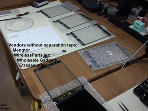

So to visually display GtechiRepair's comment which was very useful to me by the way:
These black tapes and the clear tape you peal off here are positioned on the red squares here:

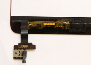

I had the same problem when installing a new digitizer (black) with home button preinstalled.
The home button was working outside the ipad, but not working when fully installed. Deinstalled the digitizer and put kapton tape on the home button flex cable.
After that everything was working fine.
See picture below where I put the kapton tape.
just went through the same thing on an ipad mini, their should be tape keeping the connections to the home button from shorting to the frame. they were exposed to le left side of my home button. covered them with tape and button works fine

Another one to keep an eye out which can be missed, is the contacts by the actual connector. Original apple digitiser will have these covered also. Just transfer any piece of tape thats on the old on to the new, even the ones by the snap connection. Since this, I've "touch wood" never had a problem since. I used to dread an ipad mini everytime! Now the only thing that I hate is getting that lcd unstuck!!!!!

Yeah you should be fine, I prefer it when I see these types arrive. As long as the contacts are covered, and you dont pinch the cable. You should be fine.
