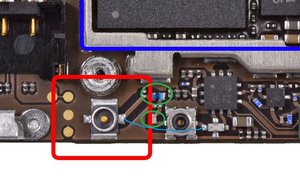

Was bought second hand, took out the logic board for further inspection, this is what I found
Man that is a mess, unless you have some serious skills and tools, you won't be able to fix that on your own. I have done repair jobs like this before and typically you need a fine-point soldering iron and/or heat gun to replace these components properly. A microscope is basically a necessity for this type of work. Also I don't know off the top of my head what components used to be there, so I would find a bad motherboard from a water damaged phone or something and steal parts and put them in exactly the same place. There are definitely missing pieces there - Most likely they are inductors for antenna tuning, and inductors are coild of wire with near-zero resistance that provide a specific impedance based on frequency. It shows 0 Ohms on your meter, but at 1900 MHz it's much higher than that, so making a short-circuit often won't help your situation.
From the pic can see that a inductor and a Capacitor is missing on your PCB.
I have attached a pic showing the components missing which are circled in green.
I have also given a solution which you can try, you have to solder a wire same as shown in blue color in my pic see it that works . . . . you can keep us posted.
If that dosent works probably you to solder those to components shown in green circle in my pic.
If you think i answered your question please rate (score) and mark it accepted. :)
Man, based on electronics fundamentals, you are making a jumper to bypass an inductor AND a capacitor, I seriously doubt this will work properly, it will severely affect the impedance and possibly make it worse. Personally, I think the best option is to replace the components with identical components. Buy a smashed up iPhone and jack the parts from the motherboard, and that will work for sure, I guarantee that. If you knew the exact component values, you could purchase these pieces individually on Digikey.ca for about 12 cents/piece, and pay 8$ shipping Canada wide.

I see your logic based on the PCB traces that you are jumping, and I'm sure it could work but I would expect a lack of performance, slightly less reception than the iPhone was designed for. If you bypass a tuning capacitor and inductor like that, the antenna will no longer have 50 Ohms impedance as seen by the IC in your picture at the design frequency, and sensitivity will most likely decrease significantly, so where you would normally have 4 bars reception, you may only get 3 or 2. It would at least get the phone up and running again though, personally I would advise going for 100% repairs and put it back the way it's supposed to be if you have the resources.

I have an iPhone 4s also with reception problems(1-2bars MAX), after taking the cover of, i noticed
the white component was completely loose (the one circled in purple on the attached picture, sorry to Varun Gargi for borrowing your pic, hope you dont mind)
picture: http://13o.imghost.us/Qy/kqF2SVK2dQ3uCpa...
anybody have a clue what this component is? or if it could be simply bypassed?

Not worth troubleshooting at the component level. You can get a motherboard for a 4S off ebay for $6
