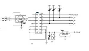

I need to bypass a button to get in recovery mode

Now the problem: I don't completely fixed the connector (that is used by the power button) because it required to solder very thin pins and I don't have the skills and the tools to do it. But now I need to use that button, so I thought "I know which pin brings the power button signal, so why don't bypass it". So I wont need to solder the thin pins. But the problem is that I don't know which voltage and amperage I should use. Any idea?

(In the other question there is the schematic of the connector too)
Giovanni Riva, take a look at the schematic from your precious question. Pin1 and 14 are the power button. Since it is a switch, you will not need to apply any power to the connector. You need to connect from point to point, in this case 1 to 14 should turn the power on. Placing a jumper across the other pins should also close the USB circuits. Pin 5-10 seem to relate to the charging circuit. Do not apply any additional power to the connector at all. Hope this helps, good luck.
First of all, sorry for the late. I was very busy with the school and well... it's spring!!! I placed a jumper (is copper cable ok?) but it didn't work. I think the problem is in the contact connector-motherboard becouse as you probably remember I readded it with superglue. I added a photo that I had made before fixing the connector. Meanwhile I'm trying to get the connection between them. The problem is that in the photo them look so big, but they are so thin!! Thank you again, I didn't think that there has to be the other pin that bings the power to the button! :D
I managed to get it on, now I only need to hold the copper wire in position, and push the ome key and vol- button at the same time :D
Done! Now I have again a phone! thanks you! (meanwhile I fixed the power button with a homemade solution :D )
