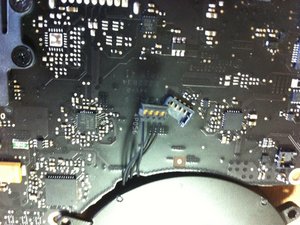

I had the same problem. Soldered some extra wires directly to the spots on the logic board and connected those with the fan wires (connector cut off).
Messed up one of the connections. Luckily I found an other spot on the logic board with the multimeter which was connected to the original pin. Haha. Nerdy.

This is not a huge deal. I just accomplished this feat in less than 30 minutes with a $30 investment in a micro solder tip for my iron and 0.015" solder. You just have to have a little confidence and a little patience.
If your fan connector breaks off, DO NOT PANIC! You do not need a professional. If you're looking for help on this site, then most likely, you have done small repairs before. So, here is what I did, and I believe if you found this column, you can probably do it to.
1. Take the bottom cover off your Macbook Pro.
2. Using a set of helping hands, I clipped the edge of the fan connector in the tip of the alligator clips, and positioned them directly where I needed the fan connector on the board. If you have a decent set and play around with the positioning this should not be a huge deal.
3. Make sure you have a solder iron with a micro solder tip attached. This will look like a bent tip that comes to a needle point. They can be found at radio shack, that is where I bought mine this morning.
4. You need 0.015" solder. I would not attempt this with anything larger due to the solder wanting to "jump connectors" when heated.
5. With the fan connector in place, soldering iron heated up, 0.015" solder in hand; lightly touch the 0.015" solder with the iron just enough to solder the connection, YOU ONLY NEED A TINY DOT! Now, that you have a tiny dot on the tip of your iron, and the fan connector in place, LIGHTLY touch the first connector pin, rubbing in a vertical motion. you will see the solder start to coat the pin and make the connection to the board.
6. Now repeat three more times.
NOTES:
1. MAKE SURE YOU ONLY SOLDER 1 PIN AT A TIME AND DO NOT TOUCH OTHER PINS WHEN SOLDERING! This can accidentally bridge your connector pins and your fan will not work properly!!!!
2. I drank a double shot of expresso prior, HUGE MISTAKE!!! My hands were shaking the entire time, aside from the coffee, I was scared shitless! I still managed to pull it off with shaky hands, so, this should not be a big deal.
3. TAKE YOUR TIME. This was an easy fix. If you don't rush, you should be fine. Feel free to write me if you'd like to see pictures, and a video of my fans working after the repair.
4. This will save you $700 or more for a logic board replacement.
5. Celebratory whiskey shot. BOO-YAH!

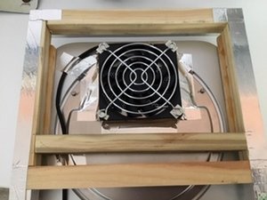

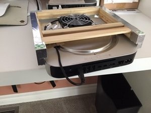

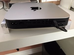

this is what i did with my mac mini fan is usb powered and from amazon $ 14.00. not pretty but works great and saved my stupid mistake
