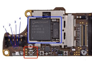

Small component broken from the logic board
Some of the small components of the logic board of an iPhone 4S are gone. It gives problems during charging. They are pointed with an arrow on the picture. What are those? Can I solve this problem by bridge the contact points? Thanks in advance.
Gauthier Top, I marked the components in numerical order. They are a follows.
1. C293 100PF 5% 16 V NP0-C0G Capacitor
2. R153 0.00 0% 1/32W Resistor
part of BATTERY_NTC circuit
3. R61 0.00 0% 1/32W Resistor
4. C300 100PF 5% 16 V NP0-C0G Capacitor
part of BATTERY_SWI circuit
You should get away by bridging the resistors, but I would not bridge the caps. Hope this helps, good luck.
It worked. Thank you very much!
you are welcome. Thanks for accepting my answer.
