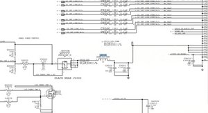

Thank you Yako, that part is exactly what I am looking for, unfortunately an engineer has identified another part that is damaged. It is immediately below pins 4 and 5 of this part (looking at it from left to right) and is labelled L9000 on the logic board. Any ideas of what this part is and where I can get it from?
Thank you oldturkey03, I can see from your diagram that it is a 250 ohm ferrite inductor, but is unclear what the ratings are for that component, i.e. the voltage, current rating, etc... Do you have any of this information?

If I understand the part you me must be this one
http://www.digikey.com/product-detail/en...
It is a ferrite chip who are responsible for the 12v on LCD Display port.
I tok this information from the schematic of Imac 21,5" who has the same connector.
I hope this is the part you need.

Are you able to post that schematic? Where would I find a schematic for the 27-inch imac, as I would have thought the bigger screen would draw more current etc
Adam Smith, I am not Yako, but thought that perhaps I can help you out with the schematic. Here is the L9000 which is a 250ohm ferrite bead used for EMI control as a filter. Check Digikey.com for more info.

Basically the issue happens because the L9000 Circuit burns if you misconnect the LCD Display cable. I followed all the hints to check the LED Start sequence as you can see on this LCD Backlight not working = solved to this problem. I noticed that LED4 was not blinking on the startup sequence.
I connect an external display using Displayport and the Mac was running fine on it.
The next step was to buy the circuit from Digi-key, as mentioned by Yako on this post. You can buy the 220 OHM Ferrite Circuit here.
Next, I take my iMac to an electronics specialist who confirmed that the Circuit was burned.
He welded it again and TADA, LCD working again!

a) The L9000 Circuit is below the GPU. So you will need to remove the logic board and the GPU (the whole thing with the cooler, etc.) Check the picture below to see where the Circuit is located
b) I Paid something like $10 for 5 220 OMH Ferrite Circuit on Digi-key. Link above.

I discovered that a blown L9000 is my problem as well on a Mid-2010 iMac 21.5inch. Attached is an image of the blown inductor, for reference to others.
You do have to remove the GPU from the slot and peel back the insulating tape to see the damage. One clue for me was you could see the tape was burnt thru, even before peeling it back to reveal the damaged L9000.
