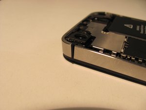

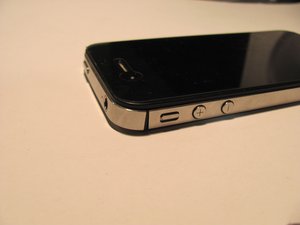

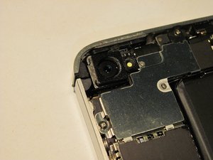

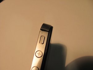

I've bought this second hand and the screen and back needs to be replaced, no biggie. But also this problem I've noticed with the frame of the iPhone but I am unsure if it can be fixed or not.
Here are 4 high-res images of the damage:
Update
Just disassembled the display off the iphone, it appears that I can't press it back in
crwdns2889612:0crwdne2889612:0 -1
This can easily be held together by the new front screen assmebly and the new back. Carefully press everything together when you place the two corner screws of the front screen assembly. The placement of the new back will help too. If there are any problems, carefully and I mean carefully, using small amount of super glue can help too.
alright then, thanks for your help but I also want to know; It seems to be holding pretty strong (back off, front on) as in unable to push it back to how it should be, but when I take the front off will it allow me to push it back into its original position easily?
