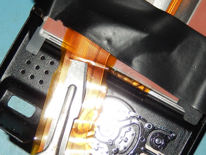

My Lumix DMC-TZ5's LCD screen turns on, but while lit, only remains plain white. Other than that, it is fully functioning, as I can see the resulting photos taken when I open the SD card on the computer.
I was wondering what I could do to check if the problem is with the LCD itself or if it's something with the electronic components, that wouldn't be fixed by simply replacing the screen. I just don't want to buy a new screen, replace it, and then find out that the problem remains.

Lui Farias, the plain white is the backlight. You are not getting any image signal. One way to make sure that it is your LCD, is by taking a couple of pictures. If the images are okay, it most likely is your LCD. If not, you have issues either on the lens connector or with your logic board. Check your cable to make sure it is properly seated and that you have no corrosion on your connector, the cable and the logic board. Hope this helps, good luck.

It definitely sounds like the LCD connector has loosened, you can try to disassemble the camera and reseat it however be VERY careful of the flash capacitor. It holds a very high voltage and can give you a nasty shock if you touch it, so make sure to discharge it first!
Failing that, it is probably a failed LCD. If even replacing the LCD doesn't work, it's probably a motherboard problem, which is going to be more expensive to repair than the camera is worth.

The answer has to be generic as more than one person has the same problem. Also people have said that pushing on the back buttons, sometimes brings it back. On close inspection of the large flexi inside the camera with a microscope. I found lists of broken tracks. See picture attached. In my opinion they can not be repaired and a new display is needed.
