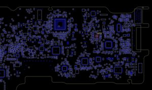

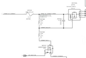

Navid km, since the cables were inversed, it is possible that you have issues with the fuse or the Mosfet. Check the fuse for continuity. It is a 3AMP-32V-467 and is available right here. Hope this helps, good luck.
F9700 is the fuse
Here is the location on the motherboard

This is in respond to an email. The backlight driver is U9701 on the motherboard. It is a LP8550. the datasheet is available right here. Hope this clarifies it further.

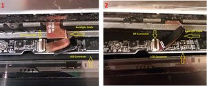

I have doubts how to connect the backlight cable to the ZIF connector in the LCD converter board.
The backlight cable is coming from the lid and the converter board is connected to the LCD.
Here is a picture which compares two possible ways to connect the cable to the ZIF connector. As I recall the right pic (no. 2) should be correct but it makes more sense that the left pic (no. 1) is correct. Any idea?
Number 2 is correct. It worked for me.
yes i have same problem. and I saw this post i just try picture number 2 it work
thank a lot.
How did you twist it for pic 2,,,if I tried it like that I would end up breaking the ribbon.

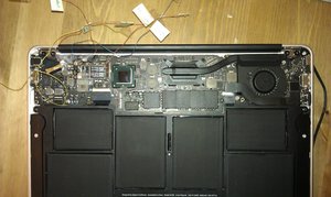

I managed to design my own board for the backlight driver, it works quit good in fact. In has the PWM as the input so that it can control the brightness. Also it has the control signal to turn off the backlight in sleep/screen saver mode.
Here is a picture of the board.
Let me know if you need further info.

Double check your backlight cable. It is the small cable in the middle of the polarizer control board. It has to be installed with the 2 white strips facing up and copper down.
2 white stripes facing up as in away from the control board, correct?
I originally installed it facing down and didn't get a backlight (LCD had display though). By the time I read your comment, though, I must of screwed something up because I installed it the way you said (which was a huge pain the ass and seems to against way the ribbon is folded) but not my display nor backlight works. :(
You Sir are a LEGEND. I attached the connector facing the wrong way all the time! I tried inserting it as you said, and it did not work at first, but at the second try I pushed it in further and the led strip works perfectly now!!! HERO! @Jurek

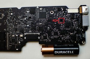

I managed to take out the logic board and locate the chip (LP8550).
Here is a picture of the board showing the place of the chip.
It seems really challenging to replace the chip with all tiny components around. I hope that is the problem with backlight..

Navid, that is why board level repair is not very common (and expensive) for any computer and even most consumer electronics. I do hope that it is the IC and that you will not have any trouble repairing it. Best of luck to you and let's hope it will work :-)
I would also recommend to test the led driver package and carefully check the LVDS connector and socket for any sign of damage. Replacing the fuse doesn't always solve the problem. A working fuse should show 12v on each side on a powered unit otherwhise there's something wrong with the circuit.

"I have doubts how to connect the backlight cable to the ZIF connector in the LCD converter board."
THe second pic is correct with the copper facing down. You've got it wrong though because the ribbon cable wraps around the inverter and back into the clip. Should be absolutely no need to twist the cable :)
This absolutely did my head in. Hope this helps others
