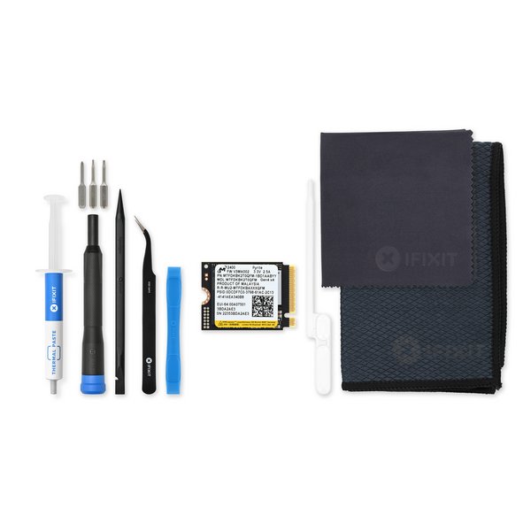

SSD - yes, can replace it up to at least 256GB
HI! How we can do it?
You simply need to buy an SD card, and there is a slot right in the side of the tablet. Keep in mind that this is not RAM, it is storage, so it will not make your Surface Pro any faster.
SSD and SD aren't the same. You'd need to crack open the tablet to replace the *SSD*
@murob2 completely different. MicroSD is what you can add for transfer or additional storage but the SSD inside is what holds the operating system and is MUCH faster. It can be replaced with a like item but if larger capacity if one wants to open the surface casing.
@Andrew Blaze , on the Pro 7+ , there is a door to open to replace SSD.
There is 512gb model of 2230 size m.2 as well.
