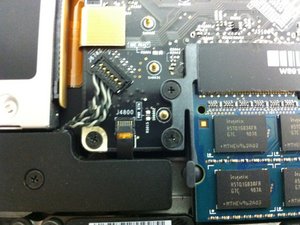

I just brought a used MacBook Pro and brought a magsafe adapter from apple store. plugged it in and get no power. no light, only on the magsafe. Battery will charge, just no power. Any thoughts?

I can show you how to open the back and boot it from the board. Sounds like the computer has power but the keyboard had liquid spilled into it and stopped working. The easiest way to find out is remove the bottom panel and boot from the pads on the logic board with a pair of tweezers. I fix liquid spilled mac's everyday. If you can send me some more info on your computer I can send you step by step photos.
Update
sorry its a bit blurry, I need a real digital camera! ANyways, these are the power pads on a 17-inch. The reason I asked you for logic board serial was so I could determine for you (and send you an image) of the correct pads. Apple in the service manual says "short the two pads together" and the easiest way is with a pair of tweezers.
I'd be really interested in a made guide by you Josh about booting from the pads on the logic board with a pair of tweezers. What are you going to do with your old logicboard ?
oh so on all logicboards it will read pwr btn?
