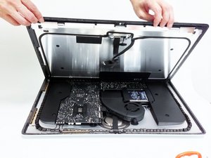

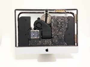

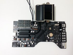

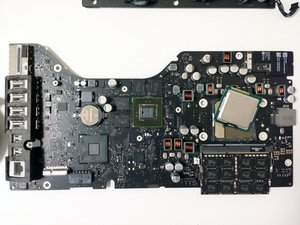

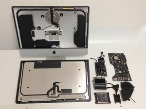

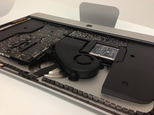

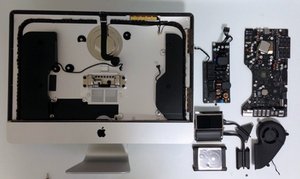

Kodawarisan had open the new iMac.
there is a slot to insert a strip SSD Apple even on the entry-level model that does not default, it will still find a way to get them or someone so this adapter connector to the SATA classic...
See opened iMac pictures from Kodawarisan
