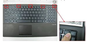

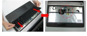

Here is what the N-Series service manual says:
1. Open 5 latches (Esc, F5, F9, Prt Sc, End) on keyboard module by a pair of tweezers.

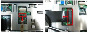

2. Turn over the keyboard plate and tear of the tape here, disconnect the LED cable and the keyboard FPC to remove the keyboard plate.

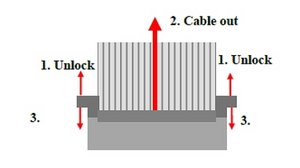

Remove Keyboard Cable
1. Use a flexible connector tool to unlock the cable connector on both ends (no. 1).
2. Carefully pull out the keyboard cable (no. 2) with a pair of tweezers.
3. Lock the connector (no. 3) again to avoid possible breakage.
