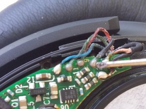

This photo shows where I soldered the negative wire on the QC15 headphones and it worked.
pet how about the positive,,ty
I only had a problem with the negative wire. However the power on/off switch may switch the positive supply so you could try and access the board at this point.

Here's a close up of the circuit board indicating where the negative power wire is located.
ash how about the positive?,,ty
