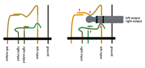

While I do understand why you think that, I can tell you the sockets are just easy to break. There's a contact shaped like the letter S which presses the plug when inserted but when relaxed presses on a contact pin. It is easily damaged either not making contact to the plug or not pressing on the contact. Open the images below I pasted an example of what it looks like inside. This is a simple mono outlet the stereo version is more complex and the units with a switch or two and offer a digital signal are the most complex and sensitive to damage.

If you have tried a known good set and it still doesn't work your socket in your MacBook Pro is likely damaged. Unlike the older MacBook Pros this model does not have a dual analog/digital socket which was mounted on the main logic board. The MacBook Pro Retina has the socket mounted directly to the case but is a bear to get to.
Here’s a good image on what is happening inside of the socket
Here's the needed steps to get to it and replace Headphone Jack iFixIt guide
Thank you for your reply. I really dont know how to check if port is damaged, cause yesterday it worked without problem (used same headphones koss porta pro and iphone headset with mic). But today, after it went to sleep while i traveled to work, it again haven't recognize headphones
With a good magnifying glass and flashlight and looking inside you can try to compare a working to a non-working unit. Sometimes it's just dirt, other times the contact is bent/broken and other times it's spun around missing the contact point and hitting something else. I first try clean it and then with a dental probe I've managed to fix a few. Sometimes it will stay working other times not until I replace the socket.
