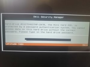

I have a problem with the bios password for the SSD hard disk. I want to solve the problem. The error code is 010704637HP-2A7B.
@gameapk this is not going to work for your drive. I don't think there is a hack for an encrypted drive.
I want a solution for that
