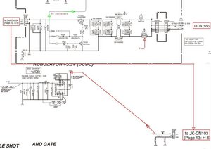

My Yamaha P-45 Digital Piano Won’t turn on, I switched the power supply and still it isn’t turning on, I have a feeling I have to switch the internal power supply, but don’t have experience in that and would love some help on what you might think it is,

Couldn’t find the service manual for a P-45 keyboard, but looking at the P-45B service manual the 12V DC input is applied to the control processor circuitry and then to a 3.3V regulator once the power has been turned by the operation of the Power switch in the keyboard. There is no separate internal power supply in the keyboard.
Hopefully the P45-B is similar to the P45 as far as the power supply is concerned, so since you have switched power adapters and it still doesn’t turn on you may have to start tracing the power input circuit to find out what is wrong.
Here’s an cropped compilation image showing the 12V power input circuit. There is a fuse in the circuit on the JK board which you may want to check first and then the power goes from the JK board to the DM board through a cable harness, so maybe one of the cable connectors at either end may have come a bit loose etc.
If the power is OK going to the DM board then you may have to check if the Power switch is OK
The service manual gives details on how to dis-assemble the keyboard as well as the board layout etc
(click on image to enlarge for better viewing)
Hopefully a start.

Had the same problem. Went the lazy man´s path and replaced the power jack board. About $ 50.00 and now it is up and running.
Consider this: medium cost labour/low cost parts vs low cost labour/high cost parts. On top of that limitations in know how.
I am learning electronics step by step from zero. Just didn´t have enough patience and time to wait until I could solve it replacing components.
