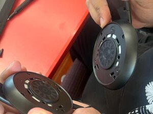

Faulty Drivers
If testing another headset on your device produces clear sound, the problem may lie within the speaker drivers of your Sennheiser HD205.
Drivers can become damaged from excessive volume, moisture exposure, or physical shock. Examine the earcups for signs of water damage or debris buildup.
If either driver is no longer functioning properly, the only permanent fix is to replace the headphones entirely, as internal speaker driver repairs are rarely practical for this model.
