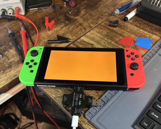

Orange Screen of Death
All the wireless communications of the Nintendo Switch's main board are controlled from a specific chip. It is also responsible for Bluetooth communications your Switch may use. If your switch crashes to or boots to an orange screen periodically, this may actually indicate hardware failure of the WiFi controller.
  • This often happens at random—sometimes at boot, or sometimes in the middle of something unrelated. The only way to get it to resolve is to hard shut the device down (press and hold power for 12 seconds).
If this happens often, especially if accompanied by wireless connectivity issues, a trip to a board repair specialist is in order.
  • The underlying cause is typically a disconnect (cracked solder joint) between the WiFi controller and the board due to drop or bend. Or the controller itself is faulty. Either way you will need microsoldering know how to fix this issue. Or to replace your motherboard.
