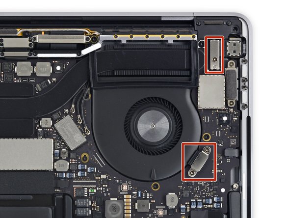

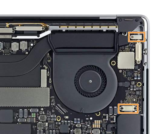

  • To determine if this is the issue, open up your Mac, and disconnect both touch bar connectors (there is one for the display and one for touch functions).
Connectors in 13" MacBook Pro
Connectors in 15" MacBook Pro
  • If your Mac boots properly and allows you to log in without the Touch Bar connected, you'll need to replace it to correct this fault. Or leave it unplugged and swear off its use.

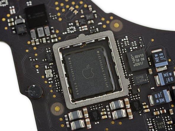

MacBook Pros, starting with the 2016 Touch Bar model, include a coprocessor alongside the Intel CPU. It manages some of the peripherals, especially ones involved in secure operations.
Apple called the initial version T1, followed in 2017 by T2. These coprocessors are modified CPUs from other Apple devices. They are intended to optimize security and power efficiency by offloading tasks from the more power hungry Intel CPU. They utilize their own operating system (bridgeOS) and are responsible most notably for Touch ID and Touch Bar function as well as integration with the webcam and ambient light sensor systems. T2 also works with the microphone and sound systems to help support security features in addition to the voice recognition component of “Hey Siri.”
