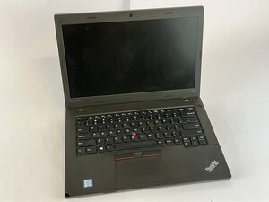

L460 Stuck in a Power or Sleep State
- Perform a power reset
- Disconnect the AC Adapter and remove the battery.
- Hold down the power button for 30 seconds to drain any residual power.
- Reconnect the battery and power adapter, then power on.
Faulty Graphic Output or Disabled Display
- Test with an external monitor
- Connect the laptop to an external display via HDMI or VGA.
- If you get output, your internal display or cable is likely the issue.
Display Turned Off or Brightness Too Low
- Adjust display settings
- Press Fn + F7 to switch between display modes.
- Press Fn + Home to increase brightness.
Loose Internal Display Cable
- Inspect and reseat the display cable
- Remove the keyboard and display bezel to access the LVDS/eDP cable.
- Ensure it's securely connected to both the motherboard and LCD panel.
Damaged or Dead LCD Panel
- Replace the LCD Panel
- Remove the bezel and disconnect the screen cable.
- Install a new, compatible LCD panel and reassemble.
Faulty Power Adapter
- Inspect for visible damage
- Inspect for frays, bends, or burn marks on the adapter cord.
- Replace the adapter cable if any damage is visible.
Adapter not providing the Correct Voltage
- Test output with a multimeter
- The Lenovo adapter should output ~20V DC.
- If there's no reading or it fluctuates, replace the adapter cable.
Faulty Adapter Unit
- Try a known Lenovo adapter cable.
- If another adapter cable works, your original is defective and should be replaced.
Damaged DC Charging Port
- Inspect or replace the DC jack
- Check for looseness or corrosion in the power port.
- Replace the port if damaged.
Static or Residual Power Buildup
- Perform a hard reset
- Disconnect the battery and AC power.
- Press and hold the power button for 30 seconds.
- Reconnect the power adapter and try turning it on.
- Check the power adapter
- Check and confirm that the power adapter delivers 20V DC using a multimeter or another working power adapter (See the 'Faulty Power Adapter' section).
Defective Battery Preventing Startup
- Boot on Thinkpad L460 without the battery
- Remove the battery, plug in the adapter only, and power on.
- If the Thinkpad L460 starts, the battery most likely needs replacement.
Loose RAM or Storage Connections
- Reseat the components
- Open the bottom cover of the Thinkpad L460.
- Remove and reinstall the RAM and SSD/HDD.
Faulty Power Button or Cable
- Inspect the power button cable
- Check and ensure the ribbon cable is properly connected to the motherboard.
Motherboard Failure
- Replace the motherboard
- If all of the above solutions fail, professional replacement may be required.
Degraded or Dead Battery Cells
- Check battery health in Lenovo Vantage
- Navigate to Lenovo Vantage > Power > Battery Status.
- If labeled "Poor" or "Replace", replace the battery inside the Lenovo Thinkpad L460.
Residual Charge Preventing Charging Cycle
- Perform a battery reset
- Power off the Lenovo ThinkPad L460, remove the AC, and the battery.
- Press and hold the power button for 30 seconds, reconnect, and restart.
Outdated BIOS or Power Drivers
- Update system firmware
- Download the latest BIOS and Power Management Driver from Lenovo's Support site.
Hardware Battery Fault
- Replace the battery
- Remove the back cover from the Lenovo ThinkPad L460.
- Disconnect the battery connector from the motherboard and replace it with a genuine Lenovo battery.
