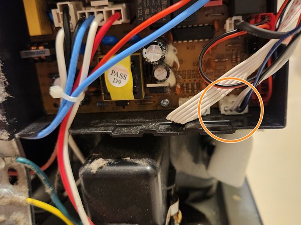

    • uncover the electronics by unclipping the specified points
    • unplug the wire connecting to the right side panel

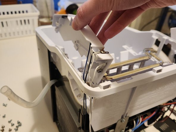

  7. ikich Countertop Ice Maker Teardown, remove side panels: crwdns2935265:07crwdnd2935265:01crwdnd2935265:02crwdne2935265:0 ikich Countertop Ice Maker Teardown, remove side panels: crwdns2935265:07crwdnd2935265:02crwdnd2935265:02crwdne2935265:0
    • remove the screws holding the side panels in-place
    • unscrew the refrigerant pipes from the side panel
    • carefully remove both side panels
  8. ikich Countertop Ice Maker Teardown, remove ice tray: crwdns2935265:08crwdnd2935265:01crwdnd2935265:02crwdne2935265:0 ikich Countertop Ice Maker Teardown, remove ice tray: crwdns2935265:08crwdnd2935265:02crwdnd2935265:02crwdne2935265:0
    • at this point, the ice tray should be freed up for removal (and cleaning)
