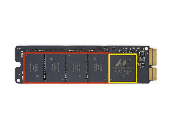

  10. iMac Intel 27" Retina 5K Display Teardown: crwdns2935265:010crwdnd2935265:01crwdnd2935265:02crwdne2935265:0 iMac Intel 27" Retina 5K Display Teardown: crwdns2935265:010crwdnd2935265:02crwdnd2935265:02crwdne2935265:0
    • This looks to be the exact same SanDisk PCIe SSD as the one found in the MacBook Pro 13" Retina Display Late 2013.
    • Unsurprisingly, we find the exact same ICs:
    • SanDisk 05131 016G 16 GB NAND Flash (four on each side, total of 8 x 16 GB = 128 GB)
    • SK Hynix H5TQ2G63DFR 2 GB DDR3 SDRAM
    • Marvell 88SS91383 PCIe SSD Controller
