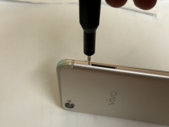

  1. Vivo X9 Teardown, Remove SIM card tray: crwdns2935265:01crwdnd2935265:01crwdnd2935265:01crwdne2935265:0
    • Remove the SIM card tray using a SIM card ejector tool.

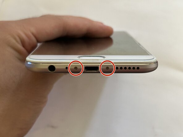

  2. Vivo X9 Teardown, Remove the bottom screws: crwdns2935265:02crwdnd2935265:01crwdnd2935265:01crwdne2935265:0
    • Unscrew the two T2 Torx screws on the bottom of the phone, surrounding the charging port.
    • The screw hole is shallow and your screwdriver will slip if it is not exactly lined up. Be patient and keep your hand steady while unscrewing.
    • While the screw technically is a T2 Torx screw, a 0.7 mm Hex screwdriver may also work sometimes.
