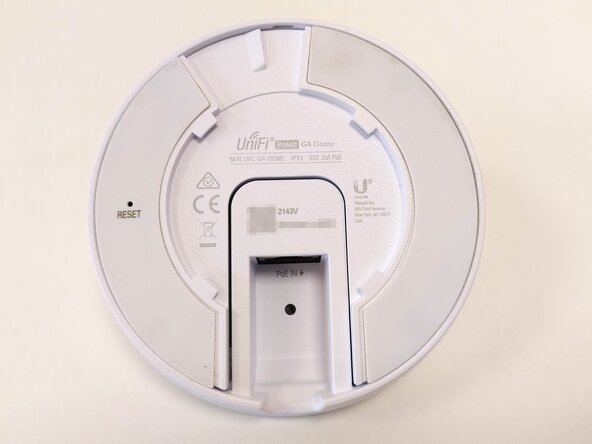

  1. Ubiquiti UniFi Protect G4 Dome Camera UVC-G4-DOME Teardown, Cover removal: crwdns2935265:01crwdnd2935265:01crwdnd2935265:03crwdne2935265:0 Ubiquiti UniFi Protect G4 Dome Camera UVC-G4-DOME Teardown, Cover removal: crwdns2935265:01crwdnd2935265:02crwdnd2935265:03crwdne2935265:0 Ubiquiti UniFi Protect G4 Dome Camera UVC-G4-DOME Teardown, Cover removal: crwdns2935265:01crwdnd2935265:03crwdnd2935265:03crwdne2935265:0
    • Remove the two rubber adhesive strips to uncover the four screw holes
    • Remove the four small screws and lift the cover.

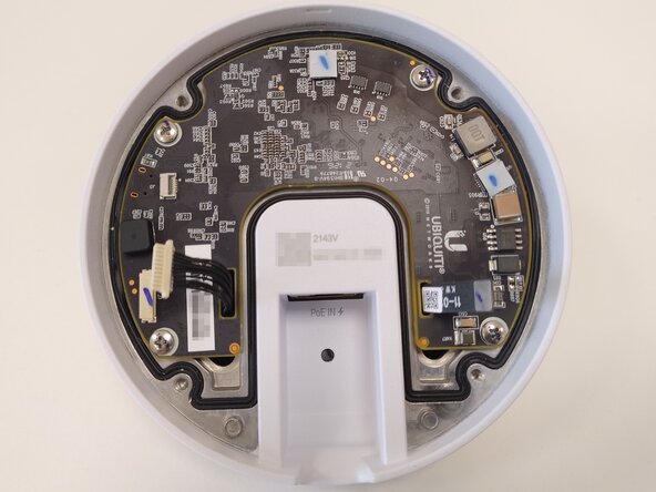

  2. Ubiquiti UniFi Protect G4 Dome Camera UVC-G4-DOME Teardown, Main board removal 1: crwdns2935265:02crwdnd2935265:01crwdnd2935265:03crwdne2935265:0 Ubiquiti UniFi Protect G4 Dome Camera UVC-G4-DOME Teardown, Main board removal 1: crwdns2935265:02crwdnd2935265:02crwdnd2935265:03crwdne2935265:0 Ubiquiti UniFi Protect G4 Dome Camera UVC-G4-DOME Teardown, Main board removal 1: crwdns2935265:02crwdnd2935265:03crwdnd2935265:03crwdne2935265:0
    • The main board is now visible.
    • Remove the four screws
    • Unplug the two highlighed connectors
    • First connector, on the left in the picture, for the leds, microphone, speaker
    • Second connector, on the right in the picture, for the ethernet port
    • You can now gently lift the main board, passing the two cables that you unplugged through their respective holes on the board. There will be a bit of resistance as there is a chip with thermal paste that adheres to the underlying metal cover
