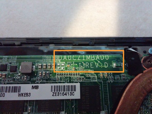

  3. Toshiba Click 2 Pro P35W-B3226 Teardown, Internals Part 2: crwdns2935265:03crwdnd2935265:01crwdnd2935265:03crwdne2935265:0 Toshiba Click 2 Pro P35W-B3226 Teardown, Internals Part 2: crwdns2935265:03crwdnd2935265:02crwdnd2935265:03crwdne2935265:0 Toshiba Click 2 Pro P35W-B3226 Teardown, Internals Part 2: crwdns2935265:03crwdnd2935265:03crwdnd2935265:03crwdne2935265:0
    • Battery Model #PA5190U-1BRS
    • Motherboard Part #DAOZC1MBADO REV:D
    • Capacitive button/dock board Part #3TCZ1T80000
    • Re-assembly in reverse order.
