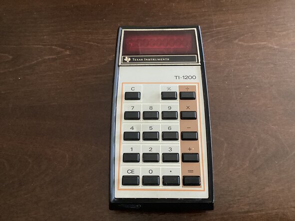

    • This is a Texas Instruments TI-1200 electronic calculator I bought at a local thrift store. It was first released in 1975, and was discontinued sometime in 1977. My version is the last model before it was discontinued, so I think it is possibly kind of rare. It also still powers on!
    • This basic calculator features an 8 digit “Bubble” LED display. It also uses a standard nine volt battery.

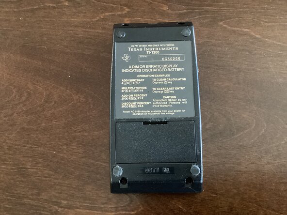

    • To start dissasembly of your calculator, you will need a Philips Screwdriver.
    • Remove all four screws from the case of the calculator in order to open the case.
