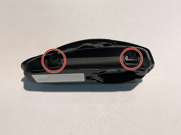

  2. Tesla Model X Key Fob Teardown, Remove sides: crwdns2935265:02crwdnd2935265:01crwdnd2935265:03crwdne2935265:0 Tesla Model X Key Fob Teardown, Remove sides: crwdns2935265:02crwdnd2935265:02crwdnd2935265:03crwdne2935265:0 Tesla Model X Key Fob Teardown, Remove sides: crwdns2935265:02crwdnd2935265:03crwdnd2935265:03crwdne2935265:0
    • Use a metal spudger to unhook the three clips on each side, front, middle, and back
    • You may have to pull down on the bottom to release the small ledges holding on the side

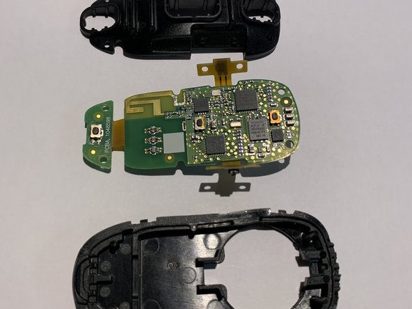

  3. Tesla Model X Key Fob Teardown, Removing top: crwdns2935265:03crwdnd2935265:01crwdnd2935265:03crwdne2935265:0 Tesla Model X Key Fob Teardown, Removing top: crwdns2935265:03crwdnd2935265:02crwdnd2935265:03crwdne2935265:0 Tesla Model X Key Fob Teardown, Removing top: crwdns2935265:03crwdnd2935265:03crwdnd2935265:03crwdne2935265:0
    • Release the four clips that have been revealed on the sides

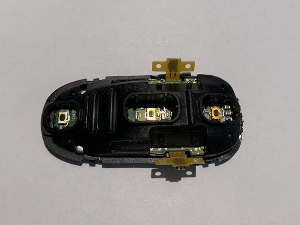

  5. Tesla Model X Key Fob Teardown, Remove side buttons: crwdns2935265:05crwdnd2935265:01crwdnd2935265:03crwdne2935265:0 Tesla Model X Key Fob Teardown, Remove side buttons: crwdns2935265:05crwdnd2935265:02crwdnd2935265:03crwdne2935265:0 Tesla Model X Key Fob Teardown, Remove side buttons: crwdns2935265:05crwdnd2935265:03crwdnd2935265:03crwdne2935265:0
    • Pop the buttons out with some tweezers and remove top and PCB

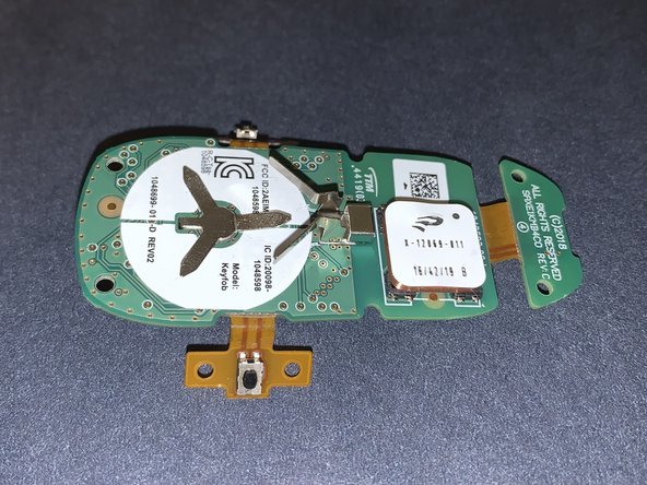

  6. Tesla Model X Key Fob Teardown, Done!: crwdns2935265:06crwdnd2935265:01crwdnd2935265:03crwdne2935265:0 Tesla Model X Key Fob Teardown, Done!: crwdns2935265:06crwdnd2935265:02crwdnd2935265:03crwdne2935265:0 Tesla Model X Key Fob Teardown, Done!: crwdns2935265:06crwdnd2935265:03crwdnd2935265:03crwdne2935265:0
    • There you have it!
    • And no glue!
    • To reassemble, go in reverse

Neat look inside the most unique key fob in recent memory. Thanks for posting!
The only thing that's missing is a rundown of the ICs on the board. If you don't mind, can you add a close-up of each side of the board and write out the numbers inscribed on each package? Armed with that info, we can see what parts and vendors Tesla used in the key fob, and this is one of the things I find most interesting.
iEvan - crwdns2934203:0crwdne2934203:0
Added images to the last step! :)
